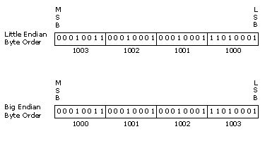

steve o. wrote:
PS whats the difference here in the picture from the ref page or am I being dyslexic?
https://software.intel.com/sites/default/files/managed/08/83/9C8C9E9B-FE4F-4EB1-B850-8CEC8A8B0618-imageId=A6A0C0E1-C865-422E-A2A0-2AD5BE5BBE73.jpg
My eyes are used to big-endian decimal strings, but it appears that the image is a work-in-progress. Moreover, I have not traced the link back to any text, so ...
mecej4
3,072 Views
