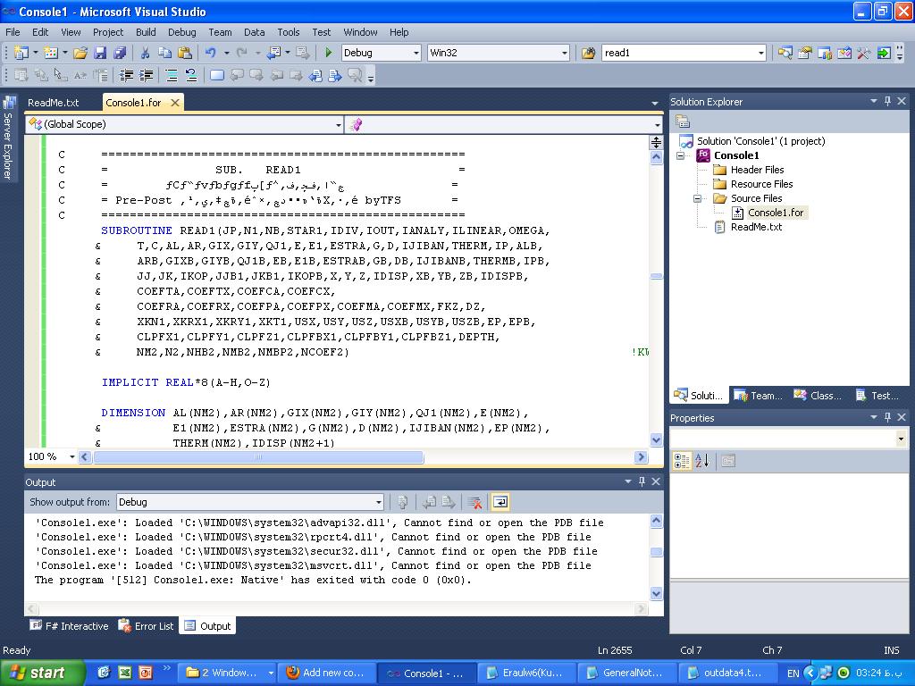

For some reason attachment doesn't show in main reply. I have to resend it always.

Your screenshot shows a single solution (named Console1) holding a single Fortran project (also named Console1), with a single source file called Console1.for. If the Console1.for file shown in the main editor window is the same as that source file in the project (for example, that is the editor window that is displayed when you double click on the Console1.for source file in the Solution Explorer and not some random file called Console1.for from elsewhere on your system) then it looks like things are set up correctly. Based on messages in the output window it looks like you have sucessfully compiled and run the program.

Yes what is visible in the main editor window, is part of my source file, which I copied into console1.for file and debug it. I run the program and got the output. I think I have passed the first step which was installing the IVF. It took more than 2 weeks to pass this step. Now I have the main step which is 3 amendments I have to make into original code and I have two weeks time. I think from now on my questions will be how to utilize FORTRAN commands in order to accomplish certain tasks. I will rely on this Forums knowledge share and support for the 2nd step as well. Thanks IanH for your support and valuable insights.
