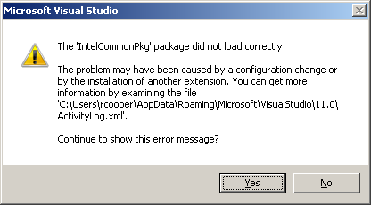

I take that back.  Now when i start up visual studio 2012 pro, i get the attached message "error on VS startup.png".
My project no longer builds, i get new linker errors "new linker errors.png" which i think are related since the project built fine before and i haven't changed anything.
Kevin_D_Intel
3,575 Views
Can you attach the ActivityLog.xml file mentioned in the startup error so we can inspect it?

Kevin_D_Intel
3,575 Views
Thank you. I gathered up that along with the earlier snap shots and reported this latest error to the IDE integration Developers for their help analyzing this and offering guidance on what can be done to clear the error and restore your setup.
