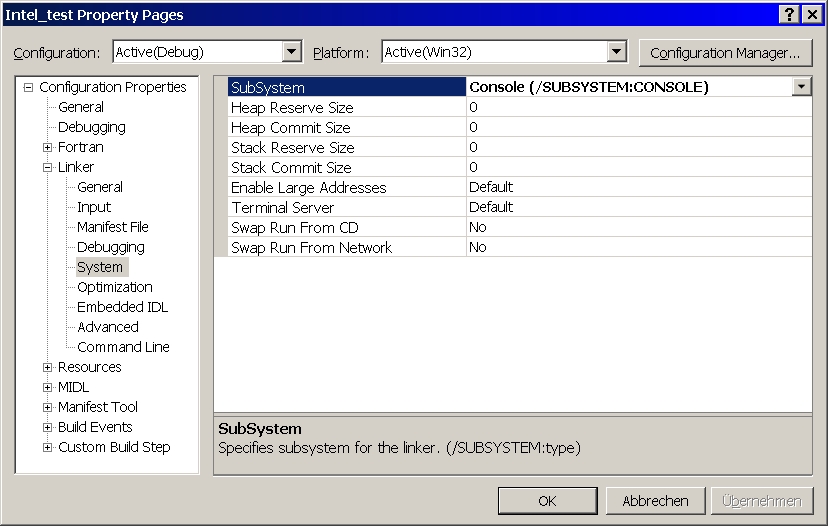

I have a dummy console application
program test
write ( *,* ) ' hallo'
call exit
end
On the write statement to stdout I get an error, that I can't writ to a file in my users-directory. It seems, that the stadout isn't set to console. What have I to do to make this work, becoause normally I work with conolse applications. With Compaq Fortran this worked.

I've never seen any problem when trying such a test by compiling from command line. If you are using Visual Studio GUI, possibly you didn't succeed in choosing a console application?
hkausl
2,617 Views
It's done in Visual Studio 2008 as a console application. Woth command-line I have the same problem.

Now I changed my user to be an administrator. Then write (*,* ) writes to the file c:\diocumen....local settings\temp\ramis_fort_print.log. The direcory is not my user-directory. The write (*,*) output is written exactly to this file. When I'm not an administrator, I can't write to this file and get an error.
Then I ichanged the statment ot write ( 6,*) , the filename changed to ramsis_fort6.log.When I look tho the environment, there are 2 variables set, FORT6 and FOR_PRINT which look exactly to these 2 files.
Then I tried write (0,*) and this seems to work. I have to test it onece more, when I have installed version 4. .
