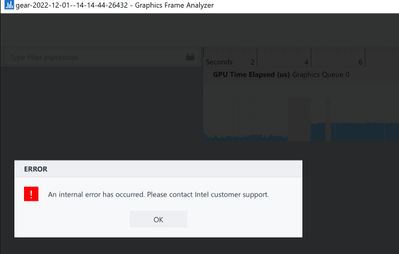

Vulkan captured a stream and I could see a series of frames and thumbnails every 5sec or so. However, clicking on a frame to analyze showed:
"Playing back to selected region"
Followed by error box:
"An internal error has occurred. Please contact Intel customer support"
So that is as far as I've got. Still not able to analyze Vulkan.

Pamela, I tried some analyzing today with little joy, same road block as last time...
Captured a Release build Stream and Frame, but can't analyze them with Graphics Frame Analyzer.
Clicking a frame in GFA shows "Playing back to selected region" (please wait animation) for some seconds, then
Error
An internal error has occurred. Please contact Intel customer support.
OK
Checking device selection top left shows correct device...
Machine is a Dell Precision laptop with Intel UHD 630 and nVidia T1000 GPUs.
Repeated the test with both external monitor and only laptop display.
So the only analyzing I can do at present, is Release build capture a Trace then view that in Graphics Trace Analyzer.
