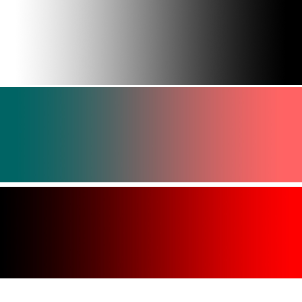

I'm using IPP 6.0.2 with Delphi 2007 and found that IPP floddfill sometimes return strang region (IppiConnectedComp) such as when using ippiFloodFill_Range4Con_8u_C1IR with the image 1000x1000 pixel. Ipp return region as (2010230698, (0, 0, 0), (0, 0, 1000, 1000)) which mean region area = 2,010,230,698 while image size only 1000x1000 (1 channel, 1 byte per pixel)
and sometimes it takes more than 1-5 minutes for flood fill image size (1000x1000) in CPU E2200. When it take long time than usual, it may return region area in minus (such as -1,853,045,006) or in bigger size than real image area, and filled area may be wrong. This often occur when use Min/MaxDelta with high value such as 100 or higher.
How can i fix this? Thanks in advance.
//This is my code. Test image is different color gradient image with 1000x1000 pixel in byte, 3 channel.

here is my test file.
http://www.digitalmaster.co.th/images/1000x1000.jpg

Hello Igor
I try
seed = (483, 463) //(at this seed RGB = (124,100,100)
newval = 0
minDelta = (100,100,100)
maxDelta = (100,100,100)
roiSize = (1000,1000)
then at the
- red channel. it return region = (197095, (0, 0, 0), (166, 288, 627, 316)). this seem work as it should be.
- green channel, it took CPU time for 3 minutes and return region = (-985044354, (0, 0, 0), (0, 288, 1000, 316))
- blue channel, it took CPU time for 3 minutes and return region = (-985044354, (0, 0, 0), (0, 288, 1000, 316))
Since my app already design to keep the image in planar. So i often use 1c instead of 3c.

In this case for green and blue chanels newval value is inside pixel's value range [0,200] ([100-minDelta,100+maxDelta]) to be filled. In such cases try to slightly correct min/MaxDelta get newVal out of pixel's value range to be filled.
Igor

Did you mean that if i use minDelta = 128, maxDelta = 128 and seed value = 128 (this should fill every pixel) / or if i use minDelta,maxDelta = 255 .. this function will always return strange region like this since i cant find any newVal out of pixel's value range?
