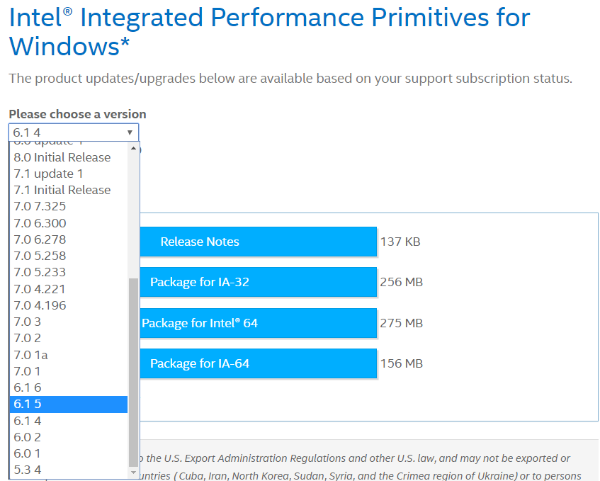

Niels_M_
2,430 Views
This is good news!
However, when I try this, I don't get all the options you see - I get only 2017 and 2017.1
Maybe it has to do with the way I registered?
Thanks, Niels
Zhen_Z_Intel
2,430 Views
Dear customer,
It is possible you may could only get the latest version of IPP that if you have a noncommercial license for free product. The Parallel Studio XE licenses do enable the older version downloads. If you have any unexpired license for IPS or ISS, you could follow this article to access older version.
