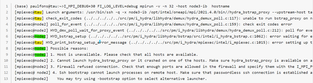

5. The command
I_MPI_DEBUG=30 FI_LOG_LEVEL=debug mpirun -v -n 32 -host node3 hostname
> hangs and gives the output (in box) below. The "clck -f nodefile -Fhealth_user" whether run as user or root returns the error message:
Nodefile could not be accessed: nodefile
(base) paulfons@tau:~>I_MPI_DEBUG=30 FI_LOG_LEVEL=debug mpirun -v -n 32 -host node3-ib  hostname
[mpiexec@tau] Launch arguments: /usr/bin/ssh -q -x node3-ib /opt/intel/oneapi/mpi/2021.4.0/bin//hydra_bstrap_proxy --upstream-host tau --upstream-port 35949 --pgid 0 --launcher ssh --launcher-number 0 --base-path /opt/intel/oneapi/mpi/2021.4.0/bin/ --tree-width 16 --tree-level 1 --time-left -1 --launch-type 2 --debug --proxy-id 0 --node-id 0 --subtree-size 1 /opt/intel/oneapi/mpi/2021.4.0/bin//hydra_pmi_proxy --usize -1 --auto-cleanup 1 --abort-signal 9
[mpiexec@tau] check_exit_codes (../../../../../src/pm/i_hydra/libhydra/demux/hydra_demux_poll.c:117): unable to run bstrap_proxy on neutrino-ib (pid 20019, exit code 768)
[mpiexec@node2] poll_for_event (../../../../../src/pm/i_hydra/libhydra/demux/hydra_demux_poll.c:159): check exit codes error
[mpiexec@node2] HYD_dmx_poll_wait_for_proxy_event (../../../../../src/pm/i_hydra/libhydra/demux/hydra_demux_poll.c:212): poll for event error
[mpiexec@node2] HYD_bstrap_setup (../../../../../src/pm/i_hydra/libhydra/bstrap/src/intel/i_hydra_bstrap.c:1062): error waiting for event
[mpiexec@tau] HYD_print_bstrap_setup_error_message (../../../../../src/pm/i_hydra/mpiexec/intel/i_mpiexec.c:1015): error setting up the bootstrap proxies
[mpiexec@node2] Possible reasons:
[mpiexec@node2] 1. Host is unavailable. Please check that all hosts are available.
[mpiexec@node2] 2. Cannot launch hydra_bstrap_proxy or it crashed on one of the hosts. Make sure hydra_bstrap_proxy is available on all hosts and it has right permissions.
[mpiexec@node2] 3. Firewall refused connection. Check that enough ports are allowed in the firewall and specify them with the I_MPI_PORT_RANGE variable.
[mpiexec@ node2] 4. Ssh bootstrap cannot launch processes on remote host. Make sure that passwordless ssh connection is established across compute hosts.
[mpiexec@node2]    You may try using -bootstrap option to select alternative launcher.

SantoshY_Intel
12,004 Views
"nodefile" is a file containing the list of available nodes in the cluster.
If the nodefile doesn't exist, then it will throw the below error:
So, create a nodefile with the list of available nodes.
For example:
$cat nodefile
node1
node2
node3
Now run the below command on node2:
The above command will generate clck_results.log & clck_execution_warnings.log along with some analysis as seen in the attached image.
Please provide us the clck_results.log & clck_execution_warnings.log

>>"There are no problems logging in, but a simple "mpirun -n 32 -host node-ib hostname" hangs."
Could you please try using the "IP address of node-ib" instead of  "node-ib"?
FI_PROVIDER=mlx mpirun -n 32 -host IPaddress-of-node hostname
For finding the IP address, use the below command on node-ib:
ifconfig
Please let us know whether "mpirun -n 32 -host IPaddress-of-node hostname" works or still hangs?
Thanks & Regards,
Santosh

paul312
11,520 Views
Hi Santosh,
  I am sorry for the delay in replying.  In effect, I have been working around the problem as I can use mpirun to run jobs on any combination of all three nodes from node1 and node3. The problem seems that I cannot submit jobs from node2 (except to node2 itself). The mpirun command hangs from node2 when directed to run a job on node1 or node3 regardless if IP addresses (infiniband or the 10Gb ethernet interfaces are used).  I am at a loss as to what to try next as obviously the infiniband and mpi are running fine when initiated from node1 or node3 which implies that node2 is connected properly to the network. I also installed the latest oneapi version to make sure that the software was the same on all three does (it ostensibly was before but a version from earlier this year).  Any ideas as to how to debug next with this new info.
Best wishes,
                        Paul
