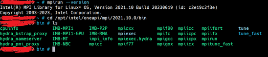

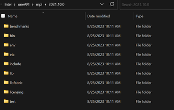

Could you please provide us the following details to check if its supported or not?
1. OS details
We have tried at our end in both linux system and windows system , we were able to get the module file with the version number of  latest oneAPI(2021.10)

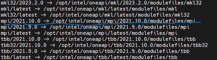

Could you please let us know from where you are referring incorrect directory paths? Could you also provide us the detailed steps to reproduce at our end?
Please find the output for the following command in the attached screenshot :
sh /opt/intel/oneapi/modulefiles-setup.sh
Are you also referring to the same path or different one?
