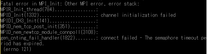

I'm setting up new MPI environment with two windows 8 pc.
Running the command below in ether order works on both machines.
mpiexec -n 1 -host machine1 hostname : -n 1 -host machine2 hostname
Then running the next command below works depending on the order. test.exe is in a newly created folder on the C drive of each machine.
mpiexec -n 1 -host machine1 test.exe : -n 1 -host machine2 test.exe
When listing machine1 first and machine2 second and running the command works on either machine. Then when the hosts list is reversed the command fails on on both machines with the following error.
Thanks in advance

As far as I see for some reasons there're the following IP addresses detected for your nodes:
Core 192.168.56.1
Eths 192.168.200.2
Are they from the same network? If no could you please try to run your scenarios with the IP addresses specified instead of the hostnames (use the IP addresses from the same subnet).
Core 192.168.56.1
Eths 192.168.200.2
Greg_G_
3,520 Views
Thanks, you found the issue.
They are both on the same network but one of the computers had a VirtualBox installed on them giving them two IP addresses (another user installed it).
Entering the main IP instead of the host names worked.
