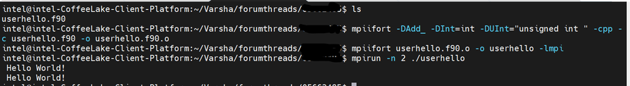

Could you please try using the 'mpiifort' at the time of compilation, as we are able to get the expected results? Please find the commands:
mpiifort -DAdd_ -DInt=int -DUInt="unsigned int " -cpp -c a.f90 -o a.f90.o
mpiifort a.f90.o -o a -lmpi
mpirun -n 2 ./userhello
Please find the below screenshot for more details.
Thanks & Regards,
Varsha
