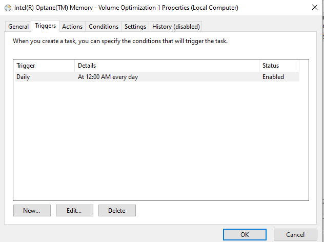

I am using the regular Optane Memory Interface, Intel® Optane™ Memory and Storage Management I provided a picture of me unable to view the Statistics. I also included my setup page too pictures provided. I also provided what it looks like in my task scheduler I might have provided too many picture but want to make sure my setup in the task scheduler is correct.windows 4.PNGwindows 3.PNGwindows 2.PNGwindows 1.PNGintel 2.PNGintel.PNG

Hello, CBrow58.
Thank you for the information and all the screenshots.
Since it's properly enabled for the secondary drive, acceleration should be working fine without you having to run the task, the Optane hardware and algorithm should select the most frequently used data stored in the drive.
We don't actually perform any type of changes or adjustments to the tasks since the Optane software takes care of everything, but I can take a look at some local systems to check how the tabs look like, I can get back to you tomorrow on this one.

Hello, CBrow58.
Thank you for waiting.
I did a quick build here in a local machine just to confirm.
When the Optane™ module is paired with a secondary drive, as in your case, I get the same error message you showed in your initial post if I try to run it manually (see below). The optimization for secondary drive will be handled automatically by the Optane™ software.
The option to schedule or run is only available when the primary drive is the one being accelerated by Intel Optane™ Memory.
Your system can stay as it is without having to perform any changes.
If I can help you with anything else, just let me know.
