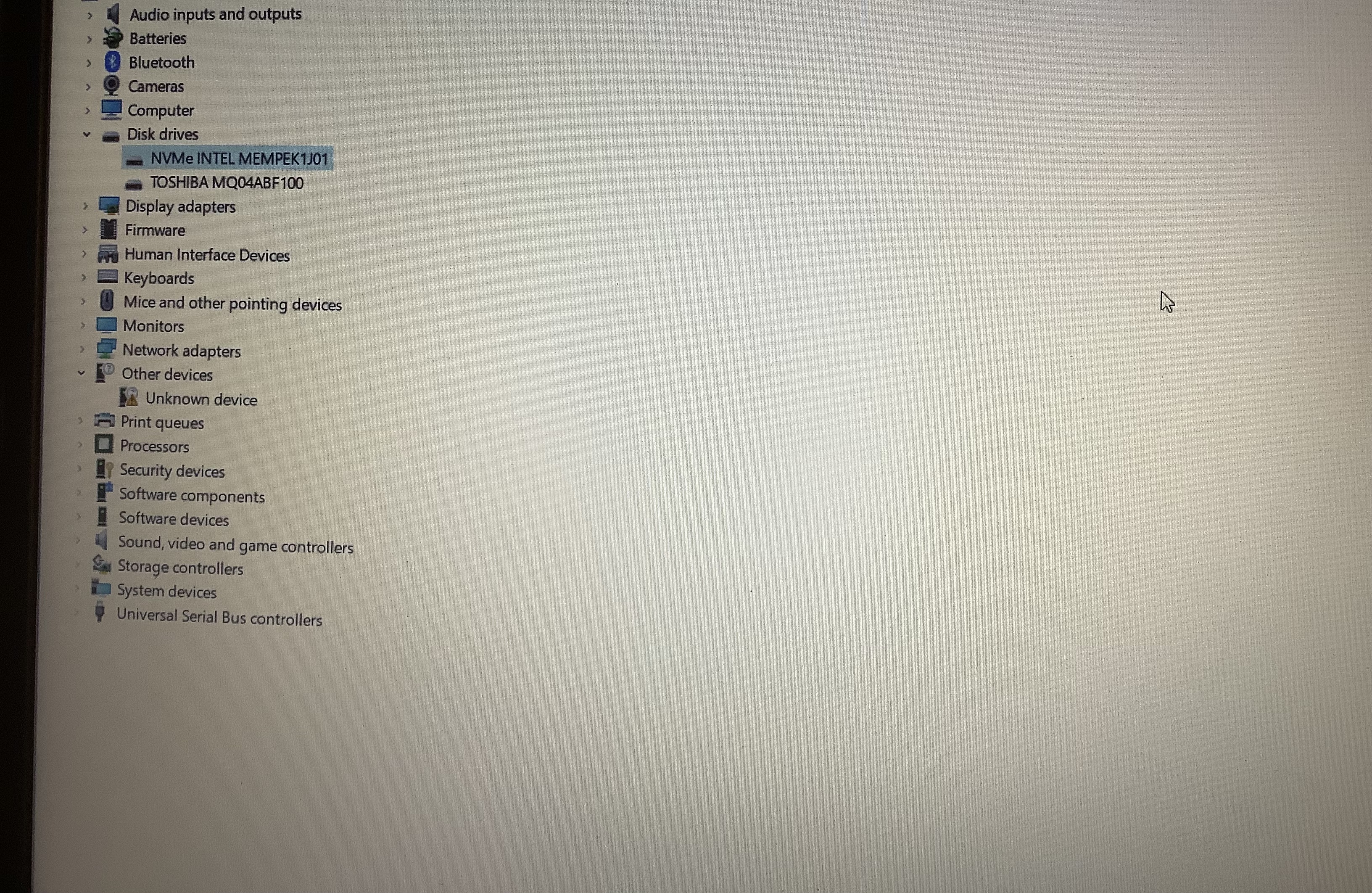

Now coming to OPTANE MEMORY , I don’t know whether it is M series or H Series . The limited knowledge I have of it is M Series is for system acceleration , and H series is more on the lines of a standard SSD . I suspect mine to be M series . How do I confirm ? . I looked up the details of the model on the ASUS website , did not find it .

Any way there is a easy way to verify if you have an Optane M Memory installed:
1. Run the installed in your laptop application: Intel Optane and Memory Management.
2. Click on "Manage" on L.H. side.
4. In the "Status" panel (on R.H. side), click on PCIe, a box should open
5. Read the model number. For 16GB module it will be MEMPEK1W016GA

Intel optane memory : MEMPEK1J01 (from device manager)
“Intel Optane and Memory Management” not found in system . This seems to be a case where the service centre technician has not enabled the optane memory (after fresh installation of windows 10)

OK, I see, you decided to stay with Optane. I'll try to give you help how to proceed:
1. Please download and read the Intel Optane Memory M Series Installation and User Guide.
Be aware that the drive to be accelerated should have GPT format/partition (rather than MBR). Make sure to leave an "Unallocated" space with minimum 5 MB in the end of HDD.
2. Download the The Intel® Rapid Storage Technology (Intel® RST) Driver (18.7.6.1010.3). The SetupRST.exe is the new installer that will install the Intel RST driver and start the process of installing the Intel® Optane™ Memory and Storage Management application from the Microsoft Store
3. Follow the installation procedure from the User Guide, to enable Optane Acceleration. If you have important data on your drive, I suggest to perform full system backup, before starting the above procedure.
