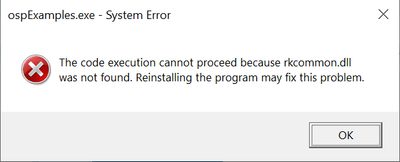

Pre-built sample application runtime errors
Base Toolkit users may have dynamic runtime issues when running Rendering Toolkit prebuilt applications. A typical error shows a popup dialog box indicating code execution cannot proceed because a dll was not found:
The code execution cannot proceed because rkcommon.dll was not found. Reinstalling the program may fix this problem.
For an environment variable script mitigation, try these options when using Rendering Toolkit:
  • Start a new cmd shell environment.
  • Run the oneAPI environment variables script in your shell:
    • call "<oneapi_install_directory>\setvars.bat "
  • Try running your program.
  • If the environment scripts do not function in your environment, the necessary paths can be set manually for your cmd shell session. Required paths will vary depending on the application you wish to run, and your library install location (either precompiled or your own application). Append lacking search path by:
    • Running the path command in the shell to see the current path.
    • New users should append all paths. Otherwise, append per component paths as needed. Examples:
path C:\Program Files (x86)\Intel\oneAPI\ospray\latest\bin;%PATH%
path C:\Program Files (x86)\Intel\oneAPI\ospray_studio\latest\bin;%PATH%
path C:\Program Files (x86)\Intel\oneAPI\embree\latest\bin;%PATH%
path C:\Program Files (x86)\Intel\oneAPI\tbb\latest\redist\intel64\vc_mt;%PATH%
path C:\Program Files (x86)\Intel\oneAPI\openvkl\latest\bin;%PATH%
path C:\Program Files (x86)\Intel\oneAPI\oidn\latest\bin;%PATH%
path C:\Program Files (x86)\Intel\oneAPI\rkcommon\latest\bin;%PATH%
path C:\Program Files (x86)\Intel\oneAPI\ispc\latest\bin;%PATH%
Precompiled programs are built with delayed load of runtimes. If they fail on seemingly arbitrary module names, then try adding all of the paths above. Example:
