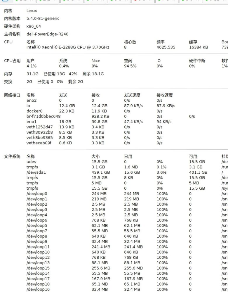

My  servers is Dell (EMC) R240, the CPU is E-2288G,  it can not achieve Intel IAS authentication because fail to SGX test . the detail information please see the attachment .
Would you please help me to troubleshooting this issue , it is really urgent for me ?

It seems that you are running the Fortanix Rust-SGX SDK.
We need some information from you to troubleshoot further. Send us results from:
$ cat /var/log/syslog | grep -i sgx
$ cat /var/log/syslog | grep -i aesm
$ dmesg | grep -i sgx
Also, send the contents of start_sgx_detect.sh so that we know what your script is doing.

Bolpan
3,659 Views
Jesus,
i am appreciate for your feedback .
The test result of the commands that you provided as below show .
I try to find the code about start_sgx from the script ,  also enclose it for reference .
This app used in phala network. you can find the detail information about Phala from the https://phala.network.
Thanks for your time to further investigation  again .
Aug 25 05:51:29 dell-PowerEdge-R240 systemd[1]: aesmd.service: Control process exited, code=exited status=127
Aug 25 05:51:29 dell-PowerEdge-R240 systemd[1]: aesmd.service: Failed with result 'exit-code'.
Aug 25 05:51:44 dell-PowerEdge-R240 systemd[1]: aesmd.service: Service hold-off time over, scheduling restart.
Aug 25 05:51:44 dell-PowerEdge-R240 systemd[1]: aesmd.service: Scheduled restart job, restart counter is at 5276.
Aug 25 05:51:44 dell-PowerEdge-R240 aesm_service[5201]: /opt/intel/sgxpsw/aesm/aesm_service: error while loading shared libraries: libprotobuf.so.9: cannot open shared object file: No such file or directory
Aug 25 05:51:44 dell-PowerEdge-R240 systemd[1]: aesmd.service: Control process exited, code=exited status=127
Aug 25 05:51:44 dell-PowerEdge-R240 systemd[1]: aesmd.service: Failed with result 'exit-code'.
Aug 25 05:51:58 dell-PowerEdge-R240 aesm_service[5846]: [get_driver_type edmm_utility.cpp:111] Failed to open Intel SGX device.
Aug 25 05:51:58 dell-PowerEdge-R240 aesm_service[5846]: The server sock is 0x55d75df751f0
Aug 25 06:02:35 dell-PowerEdge-R240 aesm_service[1178]: The server sock is 0x5642514521f0
dell@dell-PowerEdge-R240:~$
dell@dell-PowerEdge-R240:~$ dmesg | grep -i sgx
[ 2.532040] intel_sgx: loading out-of-tree module taints kernel.
[ 2.532052] intel_sgx: module verification failed: signature and/or required key missing - tainting kernel
[ 2.532371] intel_sgx: EPC section 0x70200000-0x75f7ffff
[ 2.532527] intel_sgx: Intel SGX DCAP Driver v1.41
Aug 25 05:51:44 dell-PowerEdge-R240 systemd[1]: /dev/sgx is not a device.
Aug 25 05:51:44 dell-PowerEdge-R240 systemd[1]: Couldn't stat device /dev/isgx: No such file or directory
Aug 25 05:51:58 dell-PowerEdge-R240 systemd[1]: /dev/sgx is not a device.
Aug 25 05:51:58 dell-PowerEdge-R240 systemd[1]: Couldn't stat device /dev/isgx: No such file or directory
Aug 25 06:02:34 dell-PowerEdge-R240 systemd-modules-load[421]: Inserted module 'intel_sgx'
Aug 25 06:02:34 dell-PowerEdge-R240 kernel: [ 2.532040] intel_sgx: loading out-of-tree module taints kernel.
Aug 25 06:02:34 dell-PowerEdge-R240 kernel: [ 2.532052] intel_sgx: module verification failed: signature and/or required key missing - tainting kernel
Aug 25 06:02:34 dell-PowerEdge-R240 kernel: [ 2.532371] intel_sgx: EPC section 0x70200000-0x75f7ffff
Aug 25 06:02:34 dell-PowerEdge-R240 kernel: [ 2.532527] intel_sgx: Intel SGX DCAP Driver v1.41
Aug 25 06:02:35 dell-PowerEdge-R240 systemd[1]: /dev/sgx is not a device.
Aug 25 06:02:35 dell-PowerEdge-R240 systemd[1]: Couldn't stat device /dev/isgx: No such file or directory

Bolpan
3,615 Views
Hi Jesus ,
Thanks for your suggestion and troubleshooting .
Currently, we have fixed this issue  after uninstalling and reinstalling the SGX driver&  PSW.
please close this case .
