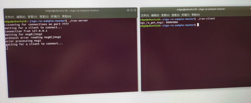

sgx_ra_get_msg1: 00004006;protocol error reading msg0||msg1 error processing msg1
desk
2,981 Views
I followthis GitHub - intel/sgx-ra-sample, but I find that I can't carry it out. This is the case now.Please give me some help. Thank you very much!

Hello desk,
According to sgx_error.h, error 4006 corresponds to:
SGX_ERROR_UPDATE_NEEDED = SGX_MK_ERROR(0x4006), /* SGX needs to be updated */
This means that you must update your SGX components. Ensure you have the latest driver, PSW, and SDK components.

JesusG_Intel
2,931 Views
If updating the SGX software components does not resolve your issue, then the problem is very likely in the BIOS. Ask your OEM for the latest BIOS.
