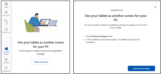

When Intel Unison is turned on in the laptop, the extended display on the bottom left does not appear
Go into the Intel driver link and complete the installation
Nevertheless, there is still no button called extended display in the bottom left of the Intel Unison app
The show me how > download package you keep talking about is possible only when at least a button called Extended display is displayed on the intel Unison app, but it is not visible
Keep getting dell sites, don't send unison app support specifications links
If you don't see the extended display button on the unison app, please let me know the solution

Thank you for raising that concern via Intel Community. To help you with the extended display concern, kindly follow the steps below:
- To check Intel® Unison™ Extended Display feature system requirements.
Refer to Premium Features and recommended system requirements.
- To install Intel® Unison™ Extended Displays
- If the Extended Display icon cannot be found in the Intel® Unison™ PC App, install the enhancement package (it is mandatory for the premium feature) by downloading the additional driver from the Intel® Unison™ app.
Or Extended display > Show me how > Download package.
- Extract the downloaded file.
- Right-click Certificate.cer and install the certificate.
- Select Local Machine → Place all certificates in the following store. Trusted Root Certification Authorities → Finish.
- Right-click UnisonIddDriver.inf > Install.
- Double-click on the executable file—IntelUnisonDriverSetup.
- After success is installed, the IDD service will be run as a background process in Task Manager.
- To enable/disable the Intel® Unison™ Extended Display feature
- Click the Extended Display icon.
- Switch ON/OFF for extended display
- Click Display Settings; it will prompt out Did you mean to switch apps?
- Click Yes; it will open Windows. Display settings

How can i find the 'extended display' icon?
I downloaded this file more than 10 times, but there was no file called certificate.cer.
In my opinion, to download cetfificate.cer, the Unison app should have extended display icon.
There are several people in this community who are having the same problem as me now, but everyone is not solving it.

Hello hotoil6,
I found a possible solution for your concern about the extended display for Intel Unison please follow the steps below:
- Uninstall the current driver > reboot laptop > clean all logs of "Intel®_Unison™_Enhanced_Capabilities_Package_xxx" from C:\Users\WindowsProfileName\AppData\Local\Temp and install latest driver 20.24.3498 from IDC.
- Make sure the latest Intel Unison PC and iPad App installed with 20.28x version.
- If the above still have same issue, please capture BE201 Bluetooth driver version from Device manager, iPad iOS version then collect all "Intel®_Unison™_Enhanced_Capabilities_Package_xxx" logs from C:\Users\WindowsProfileName\AppData\Local\Temp, zip it and send us.

Hello hotoil6,
After reviewing the details, it appears that the Samsung system model "960XHA" is not compatible with the premium version and does not support the Extended Display feature. For more information, please refer to the article What Are the System Requirements for Intel Unison App.
