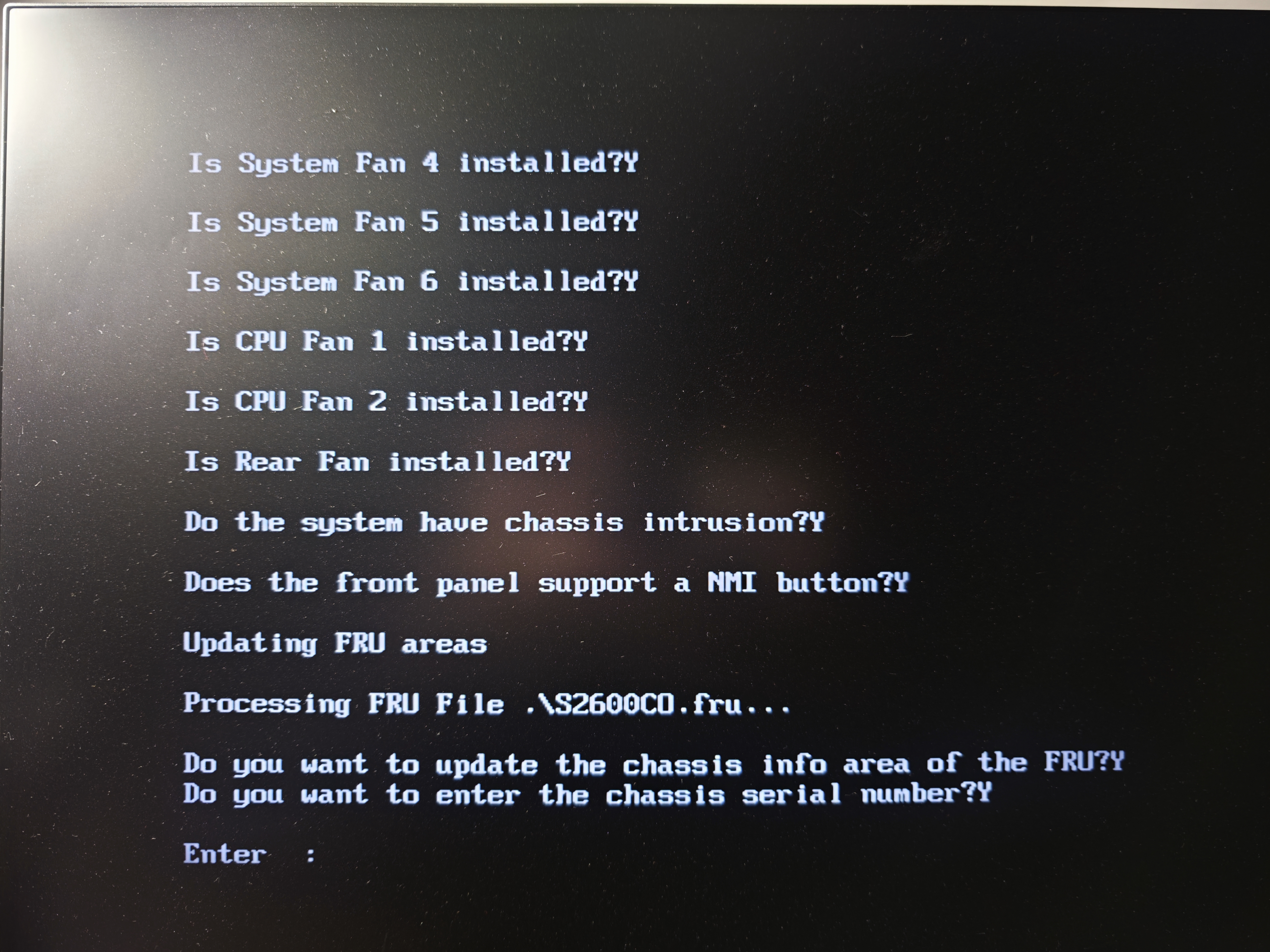

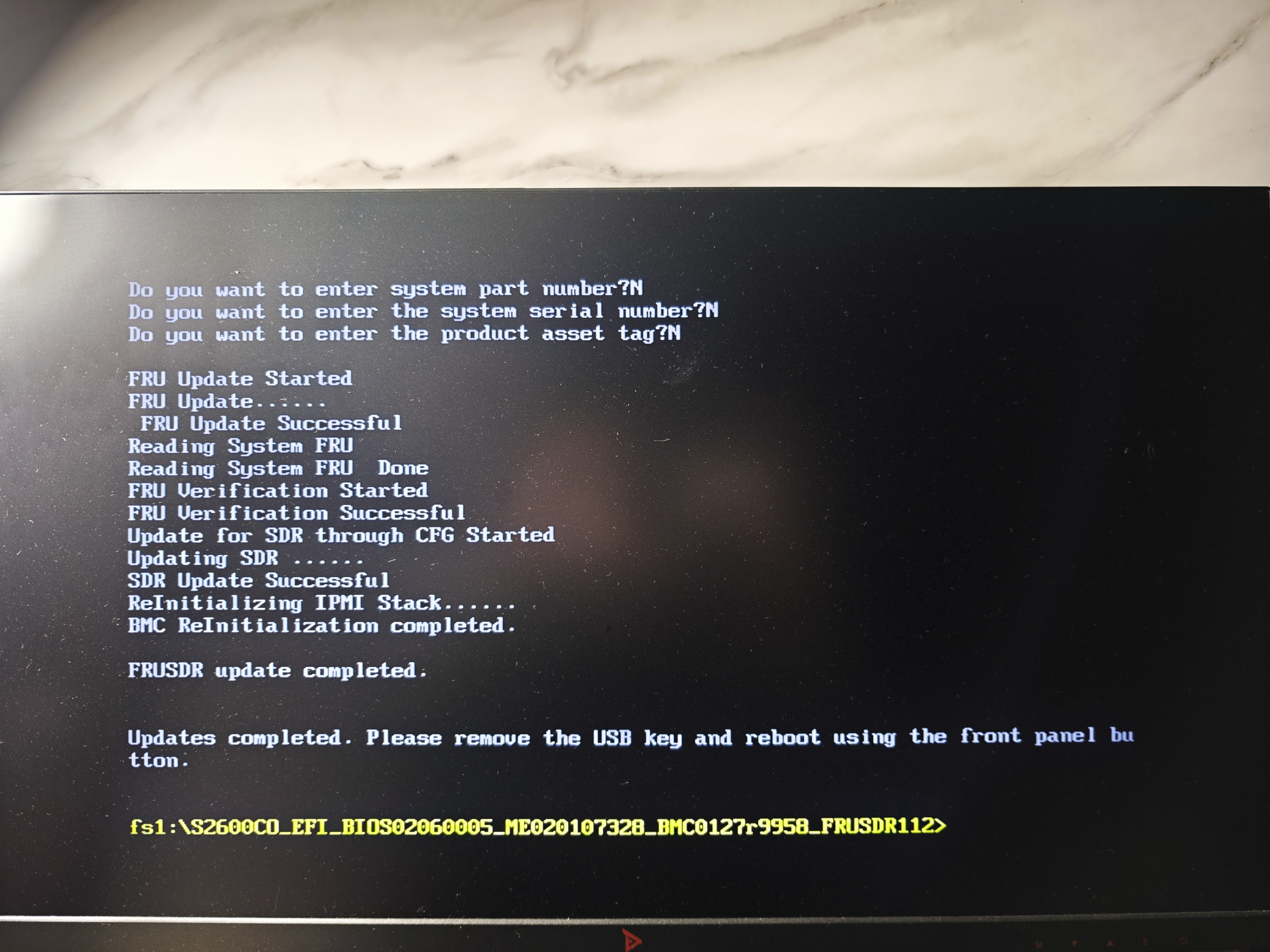

    • During a previous BIOS update, in the FRUSDR update phase, I answered "Y" to all questions regarding fan installation and other configuration prompts. After completing the update, the system fails to display any video output.
