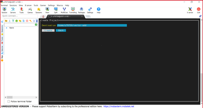

I followed the above and in the login node (where "ssh devcloud" took me) and type
oneapi-cli
a window pop up and i clicked "create a project" then "cpp" (there are the best choices i can select since this is the first time I use cli and not quite sure how to nevigate), a list of directories showed up, I tried moving (using arrow key) to vector-add project/directory but was never able to get there, pretty much everytime the screen became scrambled and I had to quite (ctrl c and exit).

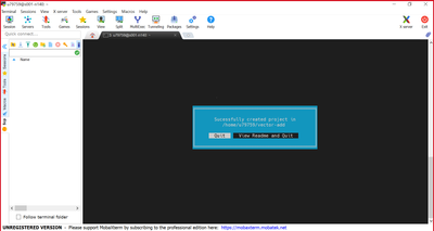

I used "qsub -I" to go to a compute node and thing got better, I was able to navigate to vector-add directory and hit return, then the following was what I saw and then I am stuck (nothing I can type to get it to respond)
RitaChu
3,209 Views
I tried it again and I was able to duplicate what you've noted above.   Thank you very much for your help.  Please feel free to close this ticket.

Please find the below steps to get samples using oneapi-cli command (if still there is any confusion).
> ssh devcould
> qsub -I ( or you can select the required node )
> oneapi-cli
After entering the above command, a window will pop up as shown below
Hit "Enter" to navigate through the next steps.
1. Create a new project
2. Select the sample language
3. Select the sample of your choice (in your case, it is  vector-add as shown in the screenshot)
4. This step shows where the created sample is stored. (path of the destination folder)
5. Final step
