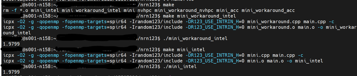

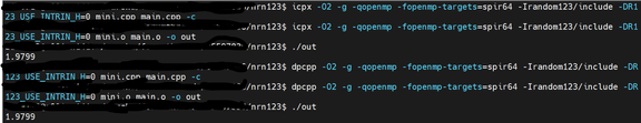

Please try using the LLVM based compilers(icx,icpx,dpcpp) as only these compilers support the OpenMP Offload feature.
We have tried your code with icpx and dpcpp compiler for both the codes(mini_workaround.cpp and mini.cpp), we are able to compile and run the code without any errors.
For more details, please find the below screenshots:

Thanks for providing the information.
At our end, we are able to run successfully without any errors. Please find the below screenshot:
Could you please let us know the node details you are using in Intel DevCloud? And also, please provide the output for "sycl-ls".
