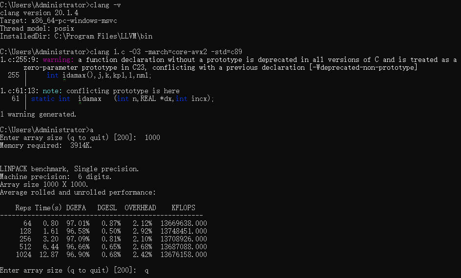

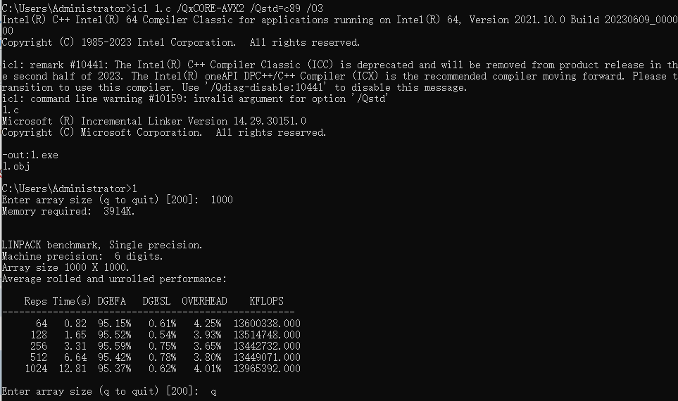

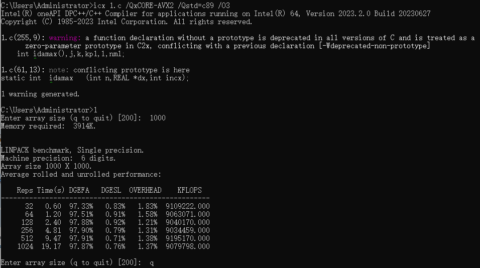

@Ethan_F_Intel @hansvz Out of curiosity I tested the linpack benchmark
The test platform is Windows.
The icx performance of 2025.1.1 is the same as that of 2023.2.0.
I also tested clang.

Based on your screenshots, unless I'm missing something it looks like icl and clang perform the same, but icx is 35% slower. Visible in both the KFLOPS and Time fields. The 1024 takes 19.17 seconds in icx, vs 12.87 in Clang and 12.81 in icl.
I have not yet tested Clang on our end because I assumed that it would at least be worse than icx.

1,084 Views
in this test, gcc is the fastest, and msvc, clang and icl are all faster than icx.
