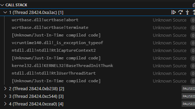

I've read that gdb-oneapi gpu debugging is only available for linux, but I thought I'd give it a try because there is a gdb-oneapi.bat in Program Files (x86)\Intel\oneAPI\debugger\2025.0\bin
I used the vector-add example, ran the setvars command in the terminal, ran cmake and then nmake. The vector-add-buffers.exe runs in the terminal as expected.
To build:
build> cmake -G "NMake Makefiles" -DCMAKE_BUILD_TYPE=Debug ..
build> nmake cpu-gpu
I set a breakpoint on the first line of code after main()
I ran the VS Code environment setup by Ctrl-Shift-P and selected "Intel oneAPI: Initialize default environment variables"
When I configure a launch.json to run using gdb-oneapi, I get a "Paused on exception" after selecting the VS Code run button.
The output in the terminal window is
& 'c:\Users\Eddie.Patton\.vscode\extensions\ms-vscode.cpptools-1.23.3-win32-x64\debugAdapters\bin\WindowsDebugLauncher.exe' '--stdin=Microsoft-MIEngine-In-4kb3mbwo.e2g' '--stdout=Microsoft-MIEngine-Out-dfzcvjax.ms4' '--stderr=Microsoft-MIEngine-Error-mj1yfego.hsv' '--pid=Microsoft-MIEngine-Pid-z10rjzt3.2cc' '--dbgExe=C:\Program Files (x86)\Intel\oneAPI\debugger\latest\env\\..\opt\debugger\bin\gdb-oneapi.exe' '--interpreter=mi'
I'm not sure why the WindowsDebugLauncher.exe is above, it doesn't seem right to me.
and VS Code shows the thread stack
I've attached the launch.json file.

Hello @eddie_patton !,
Thank you for your question,
To better understand the issue, could you please modify your launch.json configuration by adding the following logging options?:
"logging": {
"moduleLoad": true,
"trace": true,
"programOutput": true,
"exceptions": true
Additionally, in "setupCommands", please include:
"description": "logging file",
"text": "set logging enable on",
"ignoreFailures": true
After applying these changes, please share the gdb.txt file and log from the DEBUG CONSOLE.
This will help me analyze the behavior and provide a more accurate response.
