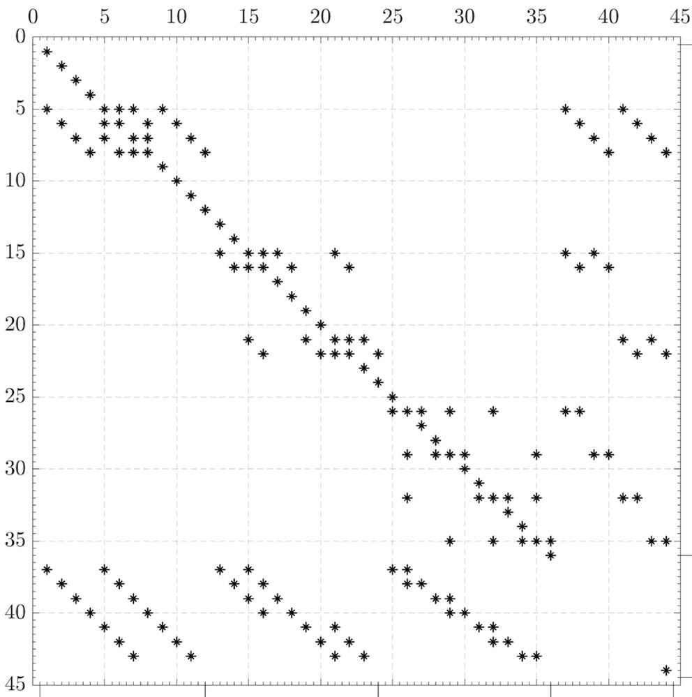

Thanks for quick response! Here is some summary about my matrix:
< Linear system Ax = b >
             number of equations:           8470528
             number of non-zeros in A:      68307067
             number of non-zeros in A (%): 0.000095
             number of right-hand sides:    1

2) It is strange that in post 3 there are different numbers of non zeroes in L,U and L+U matrixes.
3) iparm(40) = 0, matrix is stored at rank 0. I already showed you some info about my matrix:
I can add that is ill conditioned, it has a lot of zeroes on main diagonal. The portrait of matrix of a lower size is:
