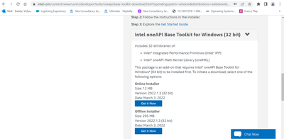

Please find the below link to download 32bit MKL for windows.
https://www.intel.com/content/www/us/en/developer/tools/oneapi/base-toolkit-download.html
After selecting the required options (OS, distribution, installer type) it will display the information of what is included in Base toolkit, and scrolling a bit down, you can see that there is an option to get "Intel oneAPI Base Toolkit for Windows (32 bit)" which includes 32-bit MKL and IPP packages.
Please find the below screenshot for more details.
Hope it helps in resolving the issue.
Please get back to us if you face any issues.
