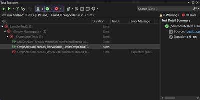

To reproduce the error, I run all these _SharedIntelTests inside the VS2022 test explorer, e.g.
Specifically we wouldn't expect the "OmpSetNumThreads_EnvVariable_LimitsOmpChildThreads" to fail.
As an interesting aside, if I only run the "OmpSetNumThreads_EnvVariable_LimitsOmpChildThreads" test by itself, the test passes.  It fails when running all the tests together though. Passing test screenshot using same code:
For environment, as mentioned we are using VS2022 with Windows 10 Enterprise Version 21H2 (OS build 19044.2604).  The Libiomp version we are using appears to be 2021.4.0

We have tried the below steps at our end to run the code and have noticed that the "OmpSetNumThreads_EnvVariable_LimitsOmpChildThreads" did not fail even while running all the tests at the same time.(See below screenshot)
1. Create new google test project in Visual Studio
2. Added your code in the test.cpp file
3. Run all test in the Test Explorer(Under Test -> Test Explorer)
Please follow the above steps and check if your issue is resolved, if it isn't could you please provide us with the exact steps you have used when you encountered this issue.
