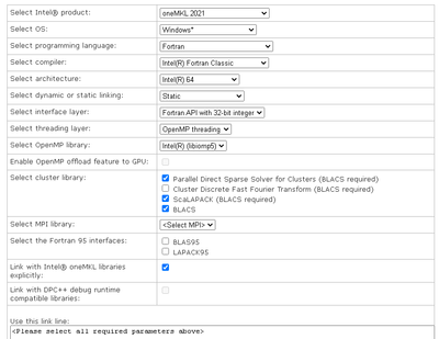

Hot to Link- see a number of examples show how to do that
https://software.intel.com/content/www/us/en/develop/documentation/onemkl-linux-developer-guide/top/...
JDFI
JDFI
5,420 Views
The linker adviser page does not generate a workable link. Do I miss anything in my option selections?

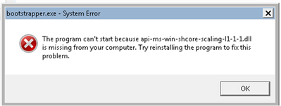

5,229 Views
Hi Gennady,
I downloaded it from the link you provided, but encountered the following error during installation.
Do you have any advice?
Thanks and have a wonderful weekend,
JDFI
Gennady_F_Intel
5,179 Views
Hi JDFI,
What version of Windows do you use?
JDFI
5,164 Views
Hi Gennady,
It is Win 7.
JDFI
Gennady_F_Intel
5,139 Views
ok, I see, thanks. Here is the link to the oneMKL System Requirements - https://www.intel.com/content/www/us/en/developer/articles/system-requirements/oneapi-math-kernel-library-system-requirements.html
Windows*
  • Windows* Server 2019
  • Windows* 10
  • Windows* (HPC) Server 2016 (64-bit version only)
Therefore, the installation doesn't support this OS.
