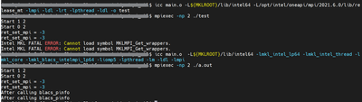

Regarding the runtime error that you are getting, I tried following the suggestions from the link line advisor (as I mentioned in my earlier post) and don't see those errors. Here is the screenshot.
linking command:
icc main.o -L${MKLROOT}/lib/intel64 -lmkl_intel_lp64 -lmkl_intel_thread -lmkl_core -lmkl_blacs_intelmpi_lp64 -liomp5 -lpthread -lm -ldl -lmpi
But the return value of the function MKL_Set_mpi is still set to -3 as you mentioned in your first post. When searched regarding the same in the MKL manual, it is already mentioned like, the function returns an error with other configurations and maybe it is the reason we are getting that as -3.
mkl_set_mpi
"Call this function to set the MPI implementation to be used by Intel® oneAPI Math Kernel Library on Windows* OS when dynamic Intel® oneAPI Math Kernel Library libraries are used. For all other configurations, the function returns an error indicating that you cannot set the MPI implementation. You can specify your own prebuilt dynamic BLACS library for a custom MPI by setting vendor to MKL_BLACS_CUSTOM
Please try the suggestions from the Link Line advisor which helps in resolving the issue with runtime error and do let me know if you have any concerns.
