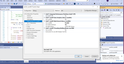

Open project properties and follow the below path.
Configuration properties  >>  Intel libraries for oneAPI  >>  Intel oneAPI Math Kernel Library  >>  (select appropriate option from the drop-down)
Please find the below screenshot
If you need any additional information please do let us know. we would be happy to assist you.
