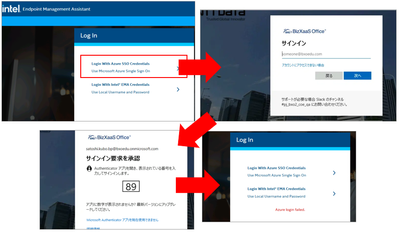

I set up the EMA server with Azure AD authentication, and when I perform SSO sign-in to the EMA management console, I go through the Microsoft authentication screen and MFA authentication, and when I return to the management console, the message "Azure Login Failed" is displayed, and logging in with the EntraID user account fails.
Furthermore, the log file contains the message "Upn <username> does not exist or is not authorized."
What setting do you think is missing?
Will I need to change the IIS web.config, etc.?

Dear IntelEMA Support Team,
As a side note, the situation is as follows.
Skubo

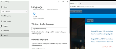

Could you please confirm if you have followed Section 1.3.2 as outlined in the Intel EMA documentation?
Currently, Intel® EMA does not support internationalization. The operating system must have English-US Windows display language, English-US system locale, and English-US format (matching the Windows display language).
For reference, please see Section 1.3.2 OS in the following guide:
[Intel EMA Server Installation and Maintenance Guide](https://www.intel.com/content/dam/support/us/en/documents/software/manageability-products/intel-ema-server-installation-and-maintenance-guide.pdf#page=10)
Thank you.

Hi Vijay N.
Thank you for your reply.
I tried changing the language settings as you suggested, but the situation did not change.
I would like to confirm the following points again. Is that OK?

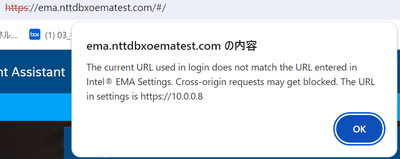

Additionally, as additional supplementary information, we have changed the URL of the EMA management console that was set at the time of construction, and the following message is displayed. Does this have an effect?
※Please ignore the security warning message.

Thank you for your response. We kindly request you to reinstall the OS. While reinstalling the OS, please select the OS language as English-US system locale and English-US format (match Windows display language). Please note that the FQDN cannot be changed. For more details, you can refer to the [Intel EMA Server Installation and Maintenance Guide](https://www.intel.com/content/dam/support/us/en/documents/software/manageability-products/intel-ema-server-installation-and-maintenance-guide.pdf#page=37).

As for changing the IIS web.config, this will change automatically after reinstalling the EMA instance.
