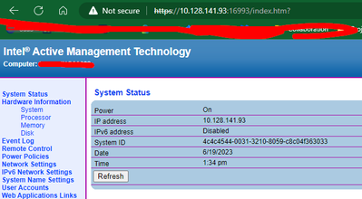

One of the engineers on my team wants to be able to connect to an Intel EMA provisioned machine via IP address, i.e. 10.132.12.3:16992 like when we configured the machine via Client Control mode in the past.
Is this possible? I have/had tested and it doesn't work.
Is the only way you can connect to an AMT provisioned machine (via ema agent) via the ema web console?

After further investigation from our end, we have determined that this behavior is expected. You can see more information on it on the link below:
https://www.intel.com/content/dam/support/us/en/documents/software/manageability-products/intel-ema-admin-and-usage-guide.pdf (page 5 section 1.2.6 intel AMT CIRA that states the CIRA creates an encrypted tunnel and additional TLS is not needed)

For anyone else with the same issue:
The Answer is NO.
To confirm EMA provisioned AMT chip can only be connected via EMA console via CIRA or TLS relay.
You cannot connect directly via IP, like you may have done in the past.
Jools86
New Contributor III
3,193 Views
The following AMT profile configuration (Enter your companies domain suffixes below), will get IP working:
However only 16992 works properly, mixed results with 16993 (Browser and Mesh Commander work - TLS untrusted), IMC fails:
