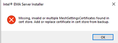

Hello, I am working through the Intel EMA installation process, but I hit a snag, I have the logs to send but I am not sure where I am stuck at, also I am not sure if I will need to restart the entire installation process or if it will kick off from where it is currently stopped, any and all help is appreciated.

We see that you are getting an error while installin the EMA Root Cert, please share the screen shot of the error that you are getting.

Here you go

Hi HoldenJolley,
Thanks for sharing the picture.
Please find the link give below for the article, which speaks about the purchase and configuration of the Root, Intermittent and the PKI certificate.
https://www.intel.com/content/www/us/en/support/articles/000020785.html
Please follow the article steps to configure the Root certificate to make sure that we are not missing any steps and share your observation.

I do have the cert, I don't believe that the cert is installed yet. But I got this error during the initial installation of EMA, is it typical to install the cert before launching the EMA Installer?
Arun_Intel1
10,899 Views
HoldenJolley,
Right, we see that you have the GoDaddy certificate purchased already. If you are provisioning the EMA in the ACM mode, yes, you may have to install the certificate as shown in the link shared.
And sure, you may continue from the place where you have stopped the EMA installation.

I did the above but now I am getting a different error before I can even finish the installation

The issue seems to be with the communication between the EMA server and the EMA database.

We would recommend uninstalling the Intel EMA server, if it is a first installation. (screen shots have been attached)
Then navigate to the certificates on the local machine, as shown in screen shot and delete all the certificates under the personal tab in the local Computer.
And reinstall EMA from the scratch and then provision the certificates once the Intel EMA server installation is successfully completed.

I tried that with no success, I did notice that my certs are a little different than what the pdf says, could this be part of the issue?

Yes, we see that this should be the one that is causing the issue, please refer to the screen shot attached, which shows the certificate options that is reflecting in the settings tab of the EMA console, and that is how it should be seen once the certificates are provisioned.
Please find the section 3.5 on the Admin and Usage guide shared below:
https://www.intel.com/content/dam/support/us/en/documents/software/manageability-products/intel-ema-admin-and-usage-guide.pdf

I have removed the old certs and got the new go daddy certs in, but I am still getting the same error message

I did manage to get past that part, so thank you for the assistance there, I made some progress before getting stuck again. So, if you are up for it How To Resolve Unable to successfully validate Azure AD settings - Intel Community is the new issue that I am having; but overall, I just wanted to say thank you for assisting me through the installation process.
