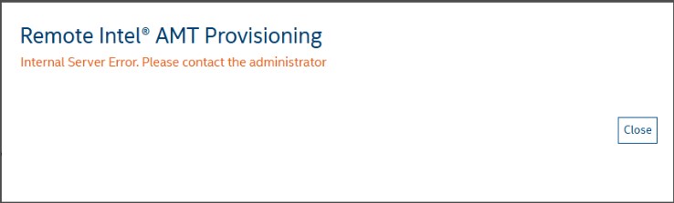

Tomhys
14,613 Views
I have updated the Intel ME with the version you provided.
I have put the FQDN of our EMA Server to the PKI DNS Configuration. If I understand correctly we need now to insert our root CA to the AMT on the specific machine ? I cant find any guide how to do this.
I have the personal and root cert on the certificate manager on said device. We dont have intermediate cert.
I imported it to IIS using the import function (complete cert request didnt work for me). Then I assigned it to the site.
The state now is that I have EMA with trusted certificate and I see the connection as secure.
The side effect is that now when I open the settings tab in Intel EMA I get "Internal Server Error. Please contact the administrator"
The same error i get when i open Provision Intel AMT window on the endpoint. Screenshots attached.
Thank you.

VijayN_Intel
11,410 Views
Hi Tomas,
I reviewed the case with our engineering team, and here are our findings:
Using the adoption method, we can see that the endpoint is provisioning successfully; however, CIRA is not establishing a connection.
During our analysis, we identified that the DNS suffix currently in use is:
The “.dom” extension is causing an issue that prevents proper out‑of‑band connectivity (Hardware Management tab).
To resolve this, we kindly request that you follow the steps below:
  1. Log in to EMA as a Global Administrator.
  2. Go to Settings.
  3. Open Manageability Server.
  4. Under CIRA Server IP, add your domain.
  5. Save the configuration.
For your convenience, I’ve attached a screenshot showing where this change needs to be made.
