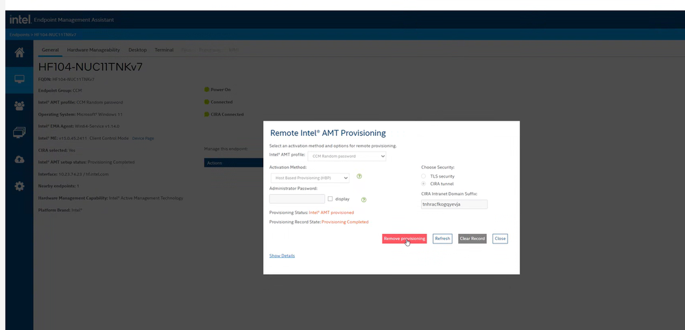

I installed the EMA agent in CCM to an endpoint for testing. The AMT Autosetup profile was set to a 6 digit random password. As part of testing, I removed management from the EMA portal as I thought that would unset the MEBx settings on the endpoint, including the password, but it looks like that only remove the entry from the EMA server and doesn't change any settings on the endpoint. My two questions are:
  1. How can I retrieve the MEBx password from the device, short of removing the battery from the laptop and draining all power, which I assume will reset the MEBx settings.
  2. How are you supposed to remotely reset the MEBx settings? Say the endpoint will be wiped and re-imaged. When our RMM pushes the EMA agent and installer, the MEBx settings will be the same as before and I assume AMT provisioning will fail.
Thanks in advance.

Hi CaptainMoloSFW,
Greetings!
Please note the answers for the queries asked:
1) Yes removing the CMOS battery is an option. Some OEM offers the option from the regular BIOS to reset MEBx BIOS (You may have to review if the option is available or not)
2)You may have to select Provisioning AMT endpoint from actions first. The option offers the random password of the endpoint.
Please find the screen shots given below for reference, for finding the random password.

When selecting Provision AMT, I get the following error message: The endpoint is provisioned by other tool and Intel® EMA does not have the record. Please use that tool or MEBx to unprovision this endpoint first
I assume this is because AMT is still provisioned from the previous install.

Hello CaptainMoloSFW,
Greetings!
Apologies for the inconvenience caused, the screen shots added has not been reflected properly, please check and confirm if you are able to see the screen shots added below:
Screenshot 3.pngScreenshot 3.pngScreenshot 2.pngScreenshot 2.pngScreenshot 1.pngScreenshot 1.png
Best Regards
Arun_Intel
CaptainMoloSFW
5,810 Views
Ok, those are the steps that I did. However, when I selected the option to Remove AMT Provisioning, that's when I get the error message:
What's the proper way to off-board a system from EMA if it's going to be re-imaged?
Greetings,
The endpoint was not un-provision properly by using the option called: Provision Intel AMT from actions. From the next window we need to select Remove provisioning.
If we provision the endpoint with the random password option, we need to select the option Stop Managing Endpoint from the action button, in the next Window the tool offers the random password.
Reset MEBx remotely is not an option for security reasons, it needs to be physically.
At this point, removing the random password is limited. We suggest using the API option.
API v1.10
https://www.intel.com/content/www/us/en/download/19693/30076/intel-endpoint-management-assistant-intel-ema-api-sample-scripts.html
Use the API: Get-IntelEMAEndpointMEBXPassword.ps1
Intel_EMA_API_Sample_Scripts_v1_10 (1).zip\PowerShell\Example Scripts
