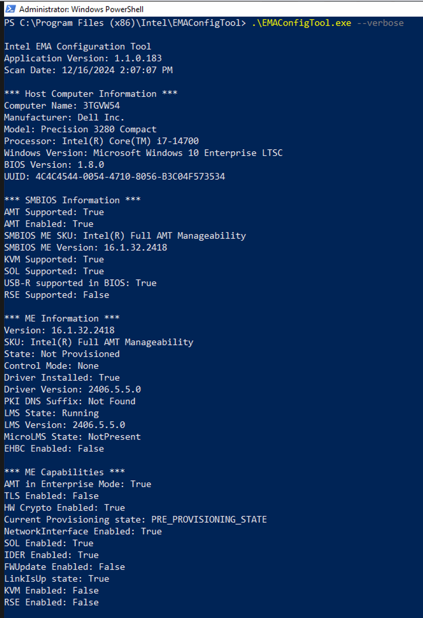

There are 3 screenshots attached showing the ECT command output.

Thanks for sharing the logs requested, as per the logs shared, we see that the control mode is unclear, hence please confirm the mode in which the endpoint has been configured?
And we do not see the error mentioned (DNS lookup failed) in the Intel EMA logs shared.
So please share the screen shot or the place where you are seeing that the DNS lookup failed error is seen.
And please share the version of the IIS server installed, the OS on the Intel EMA server and the Endpoint under consideration.

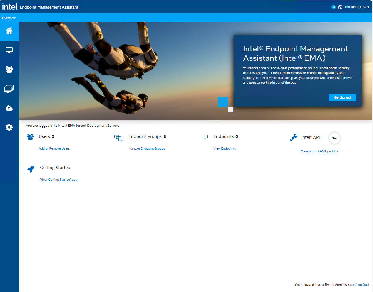

Regarding the screen shot of the home page of the Intel EMA server logged in tenant login mode, I'm unclear what this means so I have attached screenshots of the home page logged in as the Global Administrator as well as a Tenant Administrator.

Thanks for sharing the screen shots, however we wanted to verify the page where the endpoint mode is seen in the tenant admin login as the ECT does not show the mode of provisioning.
Kindly try and provision the endpoint in CCM and share your observation, as the ACM or the Admin control mode would require the TLS/SSL Certificate to be purchased and used, hence let us confirm the working first in the CCM/ Client Control Mode which would require the user consent.

I believe the attached screenshot shows the page you are wanting to see but I imagine you'll be disappointed since there are no managed endpoints yet, and thus we cannot see the mode of provisioning yet. If this is not the screenshot you're looking for, could you provide detailed instructions for how to navigate to the screen you would like to see?

Thanks for confirming that the endpoint has not been provisioned.
Please find the download link given below, where you would find the installation guide on the right side of the page, kindly refer to the installation guide where you may have to generate the agent files from the Intel EMA console and then install it on the endpoint that needs to be monitored through the Intel EMA.
