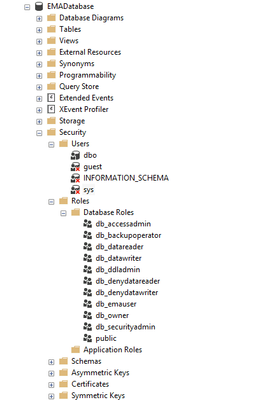

tHideo
2,096 Views
Hello.
arun_intel
I have reviewed the attached image you provided and also reviewed your request, but I would like to add a user with sysadmin privileges to the EMA database, but I do not know how to do this.
I have checked the image you provided, but where can I find the reference? Also, I viewed the image, but which roles have sysadmin privileges?
I browsed the attached image, which rolls (db_accessadmin,db_backupoperator,db_datareader) have sysadmin privileges?
I ask again, can you please tell us the procedure to add a user with sysadmin privileges to the EMA database?If possible, it would be helpful if an image is attached.
I have attached an image of the same location as the image you pasted.
We look forward to your reply.
Best regards.
Hideo.
Arun_Intel1
2,049 Views
Hi Hideo,
Greetings!
Where can I find the reference to add a SQL user?
You may have to get in touch with Microsft SQL support.
SYSAdmin refers to DB owner, The person who installed SQL software and created the EMA database needs to create the second account.
Or the person who has rights, has to right click on the users and create a User.
Best Regards
Arun_Intel
