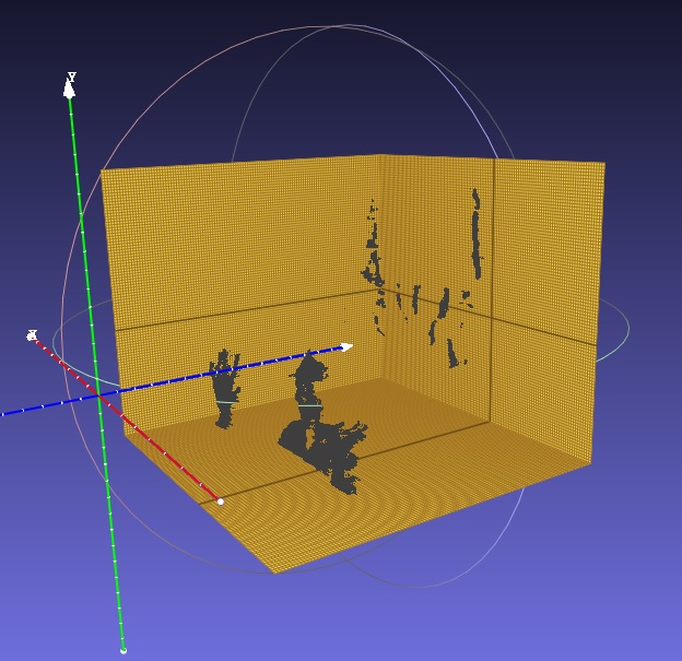

I'm using SR300, winds form application in C# , and trying to learn output depth value(w/projection), 3D point, .etc.
Although there are many similar post i have reviewed, I could not find out where is wrong with the quite straight-forward code below,
why the deptharray values are all-zero?
When converting the depth image to RGB do shows as attached.
Thanks!

It may be that the values are all being truncated to zeroes. I think in PixelFormat.PIXEL_FORMAT_DEPTH_RAW, the depth data are all less than 1 so when cast as int they end up as 0. You could either use PixelFormat.PIXEL_FORMAT_DEPTH and keep it as int or use float[] and depthData.ToFloatArray() and keep it as DEPTH_RAW (or DEPTH_F32).

Thanks MartyG and JB !
Using PixelFormat.PIXEL_FORMAT_DEPTH with .ToShortArray works.
The follow picture shows successfully my hand, face, and window behind me, and the point clouds' depth (z) are 360~1300 mm.
Too small depth value indeed should not happen when the SR300 works well.
