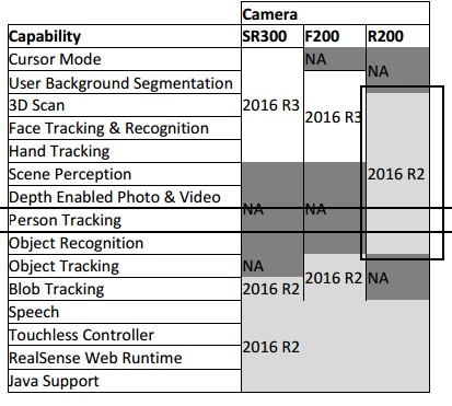

Person Tracking is listed in the release notes for R3 as being a feature only available for the R200 camera in R2, so it makes sense that Person Tracking would not function in R3.

Experience says though that just because something is in the documentation, it does not mean it is actually implemented in the official RealSense SDK. This table seems to bear that out:
'Not supported' tends to mean that the camera is capable of this feature but it has not been programmed into the SDK.
