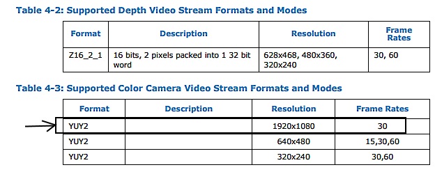

Thank you, do you know how far the ZR300 shooting distance, it supports the highest resolution is how much
The ZR300's store listing says "greater than 3.5 m indoor range and longer range outdoors".
The data sheet lists that the maximum resolution of the RGB color cam is 1920 x 1080.
Here is the ZR300's full data sheet.
