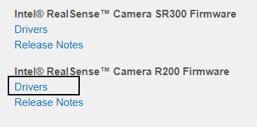

If you want to update the firmware in your R200 to 1.0.72.06, you would have to plug the camera into a Windows PC and run the Depth Camera Manager (DCM) program. The DCM that installs the newer firmware in the camera can be downloaded with the 'Driver' link in the R200 section of the page linked to below.
https://software.intel.com/en-us/realsense-sdk-windows-eol Intel® RealSense™ SDK for Windows (Discontinued) | Intel® Software

I have updated the firmware, but the error persists. Strangely I am on 1.0.72.10 now. I didnt really have anything to click using the DCM, Everything was automatically downloaded, installed and updated.
