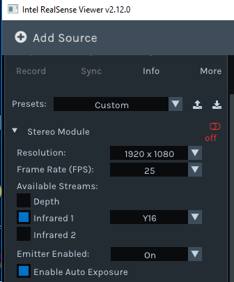

You can gain access to 25 FPS streaming in the RealSense Viewer software in IR mode if you set the resolution to the maximum 1920x1080, disable Depth and set the IR format to Y8 or Y16. If those conditions are met, the 'Off' button un-greys and becomes activatable.

Thanks Marty, that's interesting. Can depth then be enabled at 25 fps after setting color and ir?

It's slightly complicated. If you try to enable depth after successfully enabling 25 FPS then the off button re-disables. Also, 25 FPS only seems to be available for the D415 camera model, and when the camera is in Calibration mode, or using RY8_LY8 image format (Dynamic Calibration mode). Though somehow the RealSense Viewer allows that mode to be used without being in calibration mode.
