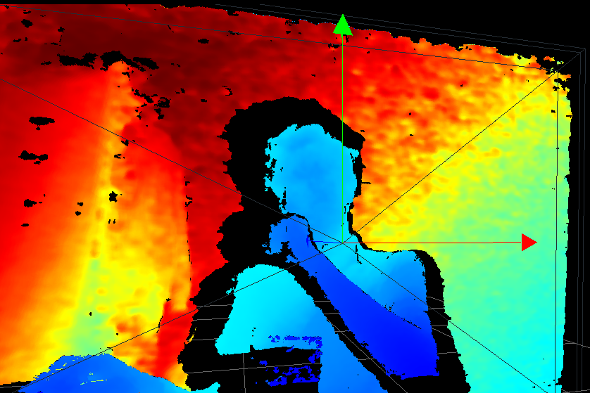

I am using Intel RealSense D435 with RealSense Viewer. When I turn the software into 3D RGB, there is a strong misalignment with the depth. In the example I sent you attached to this case, half of my head is in the background!
The depth image seems to be good, but it looks like the RGB - depth correlation is failing. I did all the calibrations as explained on your website.
I tried to use another software (RecFusion Pro), and with this one it's perfect, and I didn't even do any calibration it.
Do you have any idea why my RGB 3D images are so wrong?

It is possible to align RGB and depth in the 3D mode of the RealSense Viewer using the procedure in the link below.
https://forums.intel.com/s/question/0D70P000006AebbSAC
