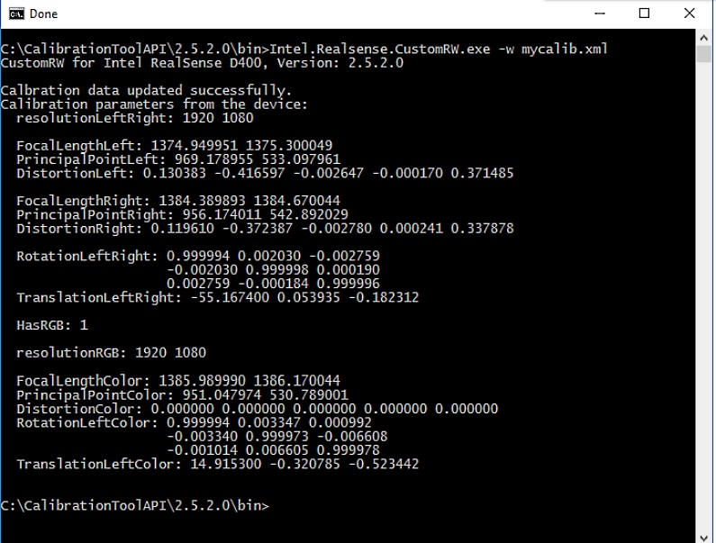

It is possible though to write calibration settings to the camera using a program called CustomRW that is part of the 400 Series cameras' Dynamic Calibration software.
The calibration software and its user guide can be found at the link below:
https://downloadcenter.intel.com/download/27955/Intel-RealSense-D400-Series-Calibration-Tools-and-API Download Intel® RealSense™ D400 Series Calibration Tools and API

If you plan to take the approach of automatically settng up the json with a script instruction, the json file would have to be loaded in from a location on your computer system when the application starts. Once the json is applied then it should remain active until the application that loaded it is closed.
For example, if you start and stop the camera whilst the application is open then the json settings should persist. But if the application is closed then the settings will be forgotten until the next time that the application is opened and the json is re-loaded when the start-up sequence of the application runs.
