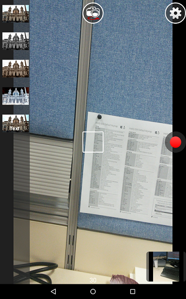

Hello Intel INDE team,
I am building an app with live streaming and am using code from the Android sample CameraStreamerActivity. Everything works great in landscape mode and I get a full screen preview. However, when I try to run this in portrait mode, I get a square preview which does not fill the screen. I've tried setting different preview sizes and even removing setPreviewSize, but I still cannot fill the whole screen.
This is a sample of how my preview looks: http://imgur.com/XUznvF1
Thank you.

Yes, we do see this issue in portrait mode of the Android Media sample. I also see you have opened this issue on Media Github. I will communicate with our team and update.

I have notified the team about the issue and we are working on it. I am waiting on reply with a fix or workaround. Will update once I get more information.

We were able to repro the issue and to best of our knowledge fix it. Could you please shoot me your email address via "Send Message" to share an engineering drop with you to try on your side?

hi guys, an update came out and this issue is still there. You can't make anything on portrait mode with the INDE which is pretty much useless without it.
any official update with this fix? this is a big big bug

There was no official update with Media for mobile. I see you have already communicated with Nick via "private message" for the package that should fix this issue.
