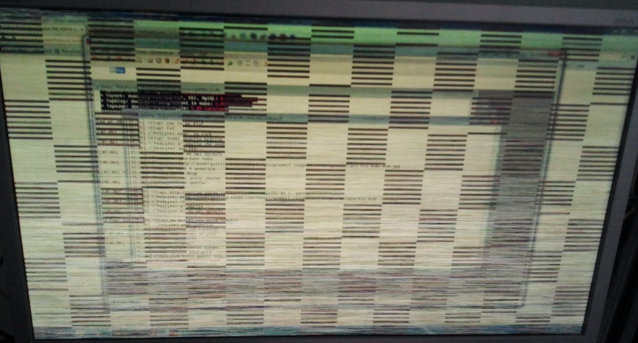

Hi i have this problem.I have an i3-2125 and i use hd 3000 gpu with latest driver
i have an asus p8h67-v mobo 8gb ram g-skill ddr 1333
and powersupply enermax pro 82 425w
i use windows 7 pro.
The problem ( see the screen ) appear randomly...on pc on idle , on pc when i surf.
Its freeze and i must reset pc.No events are signed on windows 7 log
any help? the screen is when i was using mirc

Have you seen if the issue happens in safe mode or BIOS screen? If it does not, then it could mean a driver issue. Try uninstalling the Intel® graphics driver and installing a different version.
Make sure you reset the BIOS settings to default.
If the issue appears in safe mode or in the BIOS you may have a hardware issue. Try testing the memory sticks individually
You may also want to test the processor with the Intel® Processor Diagnostic Tool.
http://www.intel.com/support/processors/sb/CS-031726.htm http://www.intel.com/support/processors/sb/CS-031726.htm
If the issue persists there is a chance you may need to start swapping components (motherboard or processor) to determine the cause of the issue.
