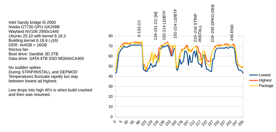

Perhaps an illustration helps for a typical build. Horizontal Time in seconds, vertical temperature. mprime results in about the same "highest core" temperatures, but since mprime takes a long time to complete. IMHO a Linux build is a more close to practical use to evaluate temperature and performance. AR , LD, BTF are build stages/commands shown in the screen through the build . No t sure why these peaks occur exactly at the points. Perhaps it has to do with how these tools behave and use CPU cores.
This is the same build on a PC from around 2012. No spikes in temperatures.
[1] Why is this "normal" and does this happen on newer CPUs ?
[2] What is the mechanism that causes this behavior ?
[3] Is there any other example/data (from/by Intel?) running such test to confirm this behavior ?
Hello Debugging,
You may notice spikes in CPU temperature whenever your processor experiences sudden increases in workload. This happens because higher CPU power consumption is converted into heat, quickly raising the core temperature.
Intel® processors are equipped with thermal and power management technologies, such as Intel® Turbo Boost and power limit controls (PL1 and PL2), which dynamically adjust frequency and power to manage these peaks. The effectiveness of your system’s cooling solution and airflow will also influence how high and how long these temperature spikes last.
During CPU-intensive tasks, like Linux builds, temperature spikes are expected especially during stages such as AR, LD, and BTF.
These tasks generate short bursts of high CPU utilization, unlike stress tests like mprime, which maintain constant load. Such bursts lead to sharp but brief temperature peaks that match the execution of specific build commands. This behavior is normal and reflects how real-world workloads use multiple CPU cores in parallel.
Please note that these temperature spikes are normal and generally not a cause for concern. Idle temperatures are lower, and higher temperatures during active workloads such as building software or gaming are expected. Intel processors continuously monitor temperature and adjust frequency and power to prevent overheating or hardware damage. The maximum operating temperature is 105 °C.
To maintain safe operating conditions, ensure that your system has an adequate cooling solution and proper airflow. If you notice persistent or unusually high temperatures, consider checking your cooling setup or contacting support for guidance.
