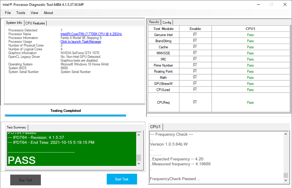

6. Intel® Processor Diagnostic Tool results:
(I was only able to run the scan with disbabled processor cores as it froze when I ran the scan with all processors enabled)

Thank you for the information provided, it seems that you're running a BIOS version from 2017. Current version is 0608 and the latest is 2001 from 2021/08/10 (as per manufacturers website). We recommend contacting Asus directly to update the BIOS, once it's up to date check the temperatures using the Intel® Extreme Tuning Utility and verify if the issue persists.
