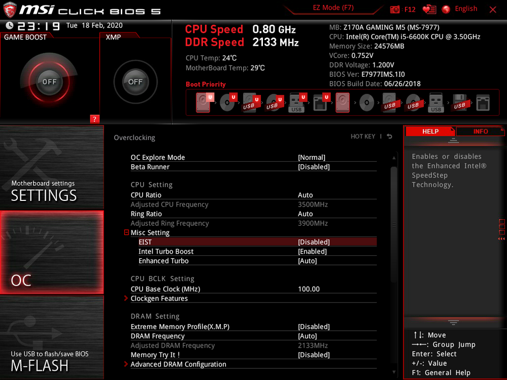

i5-6600K on a MSI Z170A Gaming M5 ATX LGA1151 motherboard (both purchased brand-new back in mid-2016)
Base clock speed of 3.50 GHz (with regular boosts up around 3.80 Ghz) but for some reason it has been going down to 0.77 GHz seemingly at random for random amounts of time. This started around 3 months ago, when I began noticing significant framerate drops while playing games. I didn't install any programs around that time prior to this issue being noticed (although I can get a list of programs installed if deemed necessary).
After some time away from this computer (hence the 3 month time frame), the problem continued, so I finally did some diagnostics and attempted to solve this issue.
Sometimes the clock speed will get back up to the base/boost speed on its own. Sometimes restarting the computer will temporarily bring the clock speed back up to base speed, and other times this issue persists through restarts (leaving the computer off for extended periods of time doesn't change this). I have experienced this issue while putting the computer under stress (gaming) and while only using an internet browser (including while typing this). I have seen the reduced speed reflected in the BIOS (it registered as 0.8 GHz), but I have never done any over clocking or changed any related BIOS setting from the default.
Thermals and utilization don't seem to be causes. I have tried the following and this issue persists:

Test behavior by disabling Intel SpeedStep Technology on your BIOS motherboard, check page 58 in User´s manual:
https://www.msi.com/Motherboard/support/Z170A-GAMING-M5#down-manual
TH-C0
12,192 Views
After disabling it, the CPU has only been running at the .77 GHz... Re-enabled (and reloaded defaults) and still stuck there.
TH-C0
12,192 Views
Here's a screenshot of the BIOS (I set​ EIST back to enabled after taking this).MSI_SnapShot.bmp
