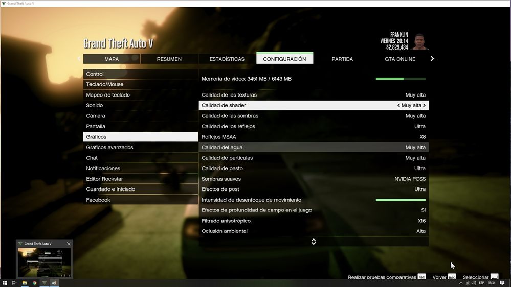

hello, a week ago I experienced a drop in performance and lack of fluency, both in games and in the environment of windows 10 1903 SO18362.175, controller version nvidia 430.86
(Excuse my English, I'm from Chile)
my pc is:
intel i5 9400f
gtx 1660ti
ssd evo 850 250gb
asrock pro4 b365m
8 gb ram 2666 hrz
I leave an example:
a week ago the games looked like this (watch the first video from minute 0 until minute 3:00)
[url]https://www.youtube.com/watch?v=qWDF2TwVLbQ[/url]
and now they look like this[url]https://www.youtube.com/watch?v=FiXqy1ZWW1w[/url]
for some it will be ridiculous, but I notice the difference.
in the windows environment I also notice that latency, for example when dragging a window from one side to another, it is not seen in a fluid way
What's going on? I need help
I have already tried with old Windows iso doing clean installation without having better results.
iso 1709

RGarc33
3,555 Views
Thank you very much for your prompt response.
1.Add the information requested.
2. I also have a loss of FPS and lack of fluency in CsGo (before between 180 and 250 fps, now between 80 and 145) Gta 5 (before between 60 and 120 fps and now between 40 and 80 fps) and in the environment of windows in general.

RGarc33
3,555 Views
1. Run the test, results attached.
2. Effectively, my ram memory is 3000 mhz. the value was automatically changed to 2400 mhz when updating my bios. again I return to 2666 mhz with automatic latency but the result is the same.
-I have not had the opportunity to try another ram memory: /
I will add a new antecedent that I have noticed since I was affected by this change.
-The textures in the games seem low quality, even with all the graphics to the maximum and activating fxxa, mssa, filters and everything else. I have read that they call it saw edges, the contour of the textures are seen as shaking, in addition to the contours of the reflections with a white border.
I do not understand what happens.
my power source is EVGA 600BQ and it is new, I doubt it is generating conflicts.
attached image.
I also opened a topic in NVIDIA:
https://forums.geforce.com/default/topic/1153902/geforce-1000-series/gtx-1660ti-performance-drop-and-lack-of-fluency-win-10-so-1903/
