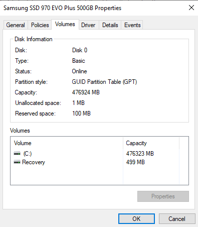

Thanks for the response, Alberto. I am running Windows 1809, and indeed installed Windows using a GPT drive (screenshot attached).
I went into my BIOS settings and confirmed that i'm booting UEFI and the other settings are enabled. Some of them were set to AUTO, so I changed them to Enabled with no success.

Alberto, I was able to get the tool to work after creating a 20GB unallocated partition at the end of the drive. Thank you for the help!
