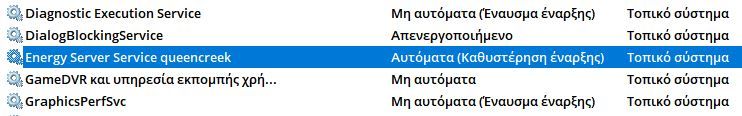

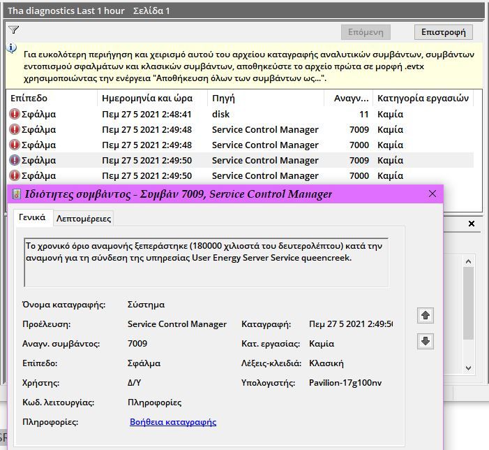

Hello.
I installed "Intel(R) Computing Improvement Program".
At Window's Event Viewer i take the error :
"The User Energy Server Service queencreek could not be started because of the following error:
The service did not respond to the startup or control request within a reasonable time.".
Also when i go to "Services" utility the "ESRV_SVC_QUEENCREEK" appears as not running.
How i can solve this (without unistall the program) ?
Thanks.

Hello buglocker,
I would like to inform you that it’s completely normal for the Event Viewer to show entries that are marked as “Error”, even on a completely healthy, normal system, you will always find errors in Event Viewer. If the tool/program/app or the laptop itself is not presenting any issues, there is no need to worry about what the "Event viewer" shows.
However, if you having an issue the "Event viewer" can help to track the reason.
With the previous statement in mind, I would like to confirm the following:
1. Based on your post, the "Intel Computing Improvement Program" is working fine and I would like to know if you are having an issue with another app/tool/program?
2. Are you having a performance issue with your laptop?
3. Have you contacted HP to get further details?
Deivid A.

n_scott_pearson
10,154 Views
The answer to all this is quite simple: simply go to the Apps & Features applet and uninstall the Intel Computing Improvement Program package. While I am sure Intel would prefer to continue collecting this information, but it just isn't worth it if the app is going to act up like this.
